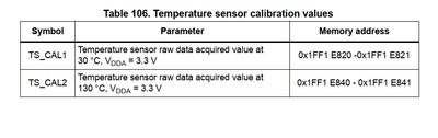

I am using ADC(16 bit) to measure the STM32H747 Internal Temperature and VrefInt based on external reference voltage (VDDA 3.3V, Vref+ 2.5V). The VrefInt result is 1.221V, which looks good. However, the temperature result is 150C, which seems not correct.
From the STM32H747xl/G datasheet, there are temperature sensor calibration values TS_CAL1(30C) and TS_CAL2(130C). The formular to get real temperature is (130-30)*(myADCValue-TS_CAL1)/(TS_CAL2-TS_CAL1)+30.
Here are my questions: 1) Is the formular correct? 2)Which reference voltage value is used when TS_CAL2/TS_CAL1 values are read during the calibration? I am using 2.5V external voltage in my design.

Thank you for the reply. I am pretty sure my ADC set up is OK because it gets correct VrefInt values(1.221V) now. My main concerns are those temperature calibration values from the data sheet. Are they based on some internal reference voltages (2.5/2.048/1.8/1.5) during the calibration measurement? My ADC design is using 2.5V external voltage(VREFBUF_CSR setting is 0x02, HIZ =1, ENVR = 0). I am guessing the ADC reference voltage makes the difference.

RM0433 Page 992 of the manual is a little vague to say the least, but TS_CAL1/2 are measured with Vref at 3V3 as far as I can tell.

It should be stated better, but they're taken with VREF+ = VDDA. The specification on VDDA is 3.3 V +/- 10 mV per the datasheet.

Thank you for the reply. I am using 2.5/3.3 factoring into the calculation temperature
ADC3 read ts_data = 17237
ts_cal1 = 12464 (30 C)
ts_cal2 = 16403 (130 C)
(100 * ((ts_data*33/25) - ts_cal1)) / (ts_cal2 - ts_cal1) + 30 = 291 C
Is this temperature correct? It seems to be too high.
I am using DMA transfer the 4 ranks ADC data. One of the rank is connected to internal Vrefint. It's result is correct because it is close to Vref calibration data from the flash. Hence, I am pretty sure the data reading from ADC channels should be good.
ADC3 read Vrefint = 32025
Vrefint *2500/(0xffff-1) = 1221 mV
Calibration data from flash vr_cal = 24193
vr_cal*3300/(0xffff-1)) = 1218 mV
Should be
(100 * ((ts_data*25/33) - ts_cal1)) / (ts_cal2 - ts_cal1) + 30 = 45 C
45 C seems right.
