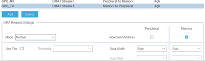

‎2024-02-12 9:19 AM
I figured out that if I put a
while(hspi3.State != HAL_SPI_STATE_READY) {}
before the DMA transmission, it stays there and it blocks it. Why can this happen?

‎2024-02-12 1:01 PM
Let's change the approach:
If you want to share data between two cores, dedicate a section of AXI SRAM as shared memory and have one core write it and the other read. This will be hundreds of times faster than sending/receiving over SPI and will be easier to code.
