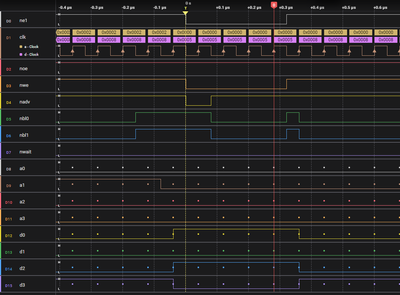

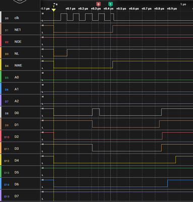

I am trying to get the FMC to work in 16-bit synchronous mode but I only get an output with 4 clocks (64-bit) instead.

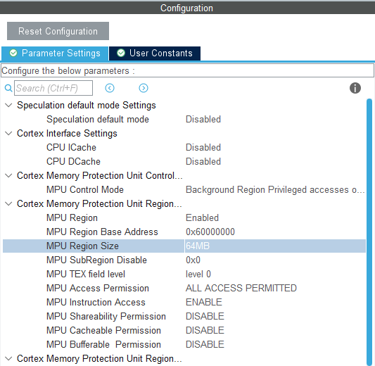

In other threads [1], [2] I found that I should either switch the address from 0x60000000 to 0xC0000000 or enable the MPU, but neither approach works for me.

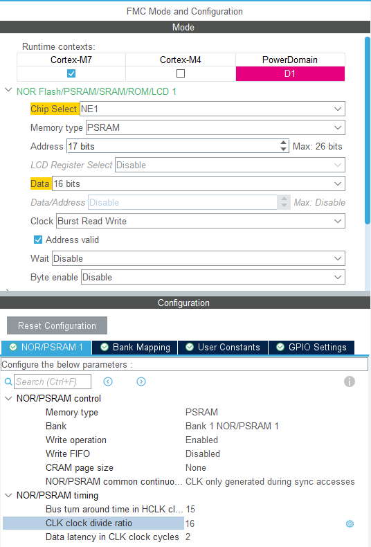

This is my config:
FMC:
MPU:
Usage:
uint16_t * psram16 = (uint16_t *)0x60000000;
psram16[0] = 0x00AA;
Output:
What am I missing?

Not sure what this means. Isn't that the MPU setting?
I also tried it without CubeMX:
MPU->CTRL = 0;
MPU->RBAR = (0x60000000 & MPU_RBAR_ADDR_Msk)
	| (1 << MPU_RBAR_VALID_Pos)
	| (0 << MPU_RBAR_REGION_Pos);
MPU->RASR = (1 << MPU_RASR_XN_Pos)		// execute never
	| (0b011 << MPU_RASR_AP_Pos)  		// access: full
	| (0b000 << MPU_RASR_TEX_Pos)		// type extension
	| (1 << MPU_RASR_S_Pos)			// sharable
	| (0 << MPU_RASR_C_Pos)			// cacheable
	| (0 << MPU_RASR_B_Pos)			// bufferable
	| (0 << MPU_RASR_SRD_Pos) 		// subregion
	| (MPU_REGION_SIZE_128KB << MPU_RASR_SIZE_Pos) 	// size: 2^(val+1)
	| (1 << MPU_RASR_ENABLE_Pos);
MPU->CTRL = MPU_CTRL_PRIVDEFENA_Msk | MPU_CTRL_ENABLE_Msk;

This leaves more questions than it answers. In the example, additionally to what I already did, another memory region at 0xA0000000 is created, no idea why since this is reserved space, but it does not help anyway. To be sure I set the whole memory to strongly-ordered, but that does not change anything. The output looks still the same, i.e. 4 clocks instead of 1.

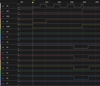

btw this is how a 32 bit access looks:
uint32_t * psram32 = (uint32_t *)0x60000000;
psram32[0] = 0x00A000A1;
5 clocks, so also 3 unnecessary clocks (or my expectation is wrong, I don’t have much experience with external memories)

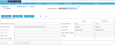

No difference with MDMA.
uint16_t src=0x1234;
HAL_MDMA_Start(&hmdma_mdma_channel0_sw_0, (uint32_t)&src, 0x60000000, 2, 1);
You can make a new project (STM32H745XIH6, FW H7 1.11.1), with the settings from the first post. I didn't change or configure anything else.
FMC is accessed right before the main while loop.
