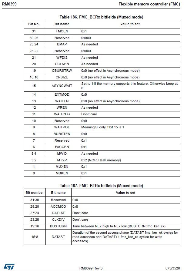

Hallo,
I'm using a STM32H745, that shall access an external NOR flash with the timing recommended by ST at the reference manual RM0399 on page 875. 0693W00000Dq5mGQAR.jpg I did exactly reproduce this timing setting, but no access will be generated on the FMC pins.
When I change one single bit in this configuration (bit 8 = BURSTEN set to 1) the access works, but of course as BURST access. My intention is a non-burst access.

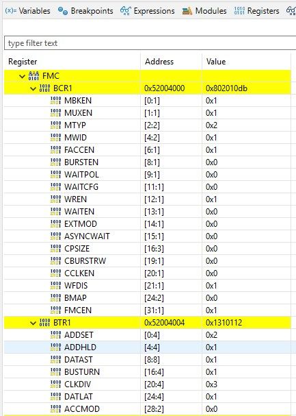

The issue can be reproduced on two ways:
First via debugger.
After configuring the pins and switching the FMC clock on, set the register BCR1 and BTR1 and generate access via memory browser.
0693W00000Dq5nEQAR.jpgSecond with the following code:
