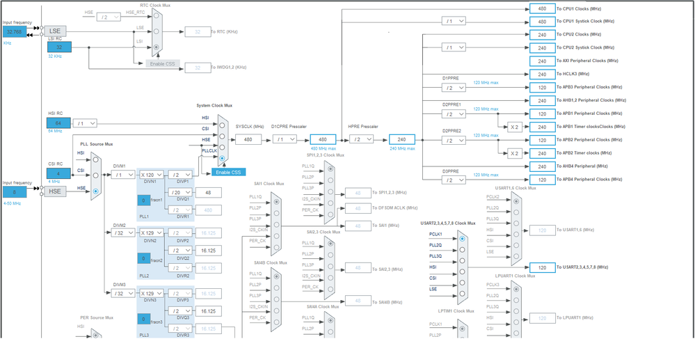

Hi guys, I tried to setup frequencies for cores to max which is possible. The code for LL was generated, compiled, but the actual frequency of core M7 (480 MHz) looks much lower than 480 MHz.
LL generated code

The clock diagram in CubeMX

> LL_RCC_HSE_EnableBypass();
It looks like you're using a clock signal as the HSE input. The chip has no way to validate that this signal is at the 8 MHz you say it is. It's possible the clock is at a different frequency than you think.
What clock speed are you seeing?
But HSE source should come from stlink osc am I right? Because X2 is not soldered.
Maybe. You didn’t say you’re using an ST board.
Yes sorry, Im using nucleo-h755zi-q dev board.
So If the source is 8Mhz, this configuration should be correct or?
Seems fine to me, but I did not study it.
You can use HAL_RCC_GetSysClockFreq to see what comes back.
Also seems reasonable to look at the RCC registers directly and see what is amiss. There aren't that many relevant registers here.
