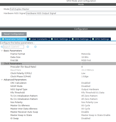

SPI4 configuration:

The process I use for SPI transfers is the same for SPI1, SPI2, and SPI4 and the set-up is the same except the SPI4 is setup as 8bit while the others are 16.

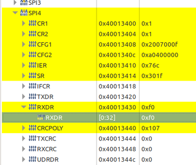

Further investigation: I cannot use the instance to see the Special Register for SPI4->RXDR. It shows 0 while the SFR's tab in the debugger shows:
So there is a disconnect there and I am not sure how the Instance structure gets updated.

Do you really keep the registers opened in the viewer while debugging the SPI? http://efton.sk/STM32/gotcha/g4.html
‎2024-05-14 08:47 PM - edited ‎2024-05-14 08:51 PM
No. I only view it when stopped and then close it.
And as far as the SFR's I only view after the transfer on the second pass to verify the the FIFO is receiving the data.
‎2024-05-14 09:35 PM - edited ‎2024-05-14 09:41 PM
Sure would like to know why when accessing the RXDR register via the hspi->Instance, the data contained after the HAL_TransmitReceive call goes from 000000000000000f to 0 and the value returned is 0?
Spent most of the day going over RM0433 with a fine tooth comb and find nothing that would solve the current behavior.
