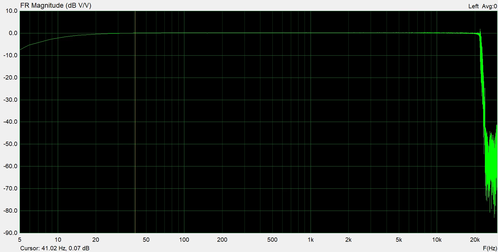

The left channel looks just fine on the audio analyzer:

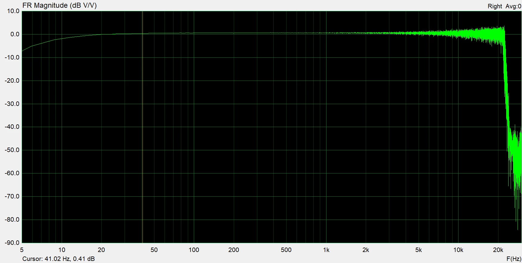

Right channel is showing a lot more noise:
It has to be a software problem, because when I use direct audio feed-through inside the DMA ISR same as with the left channel, the right channel looks fine as well. When I read the buffer in the SRAM with the left channel, the left channel is showing the same weird behavior. Both instruction and data cache as well as the MPU are disabled.

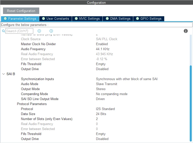

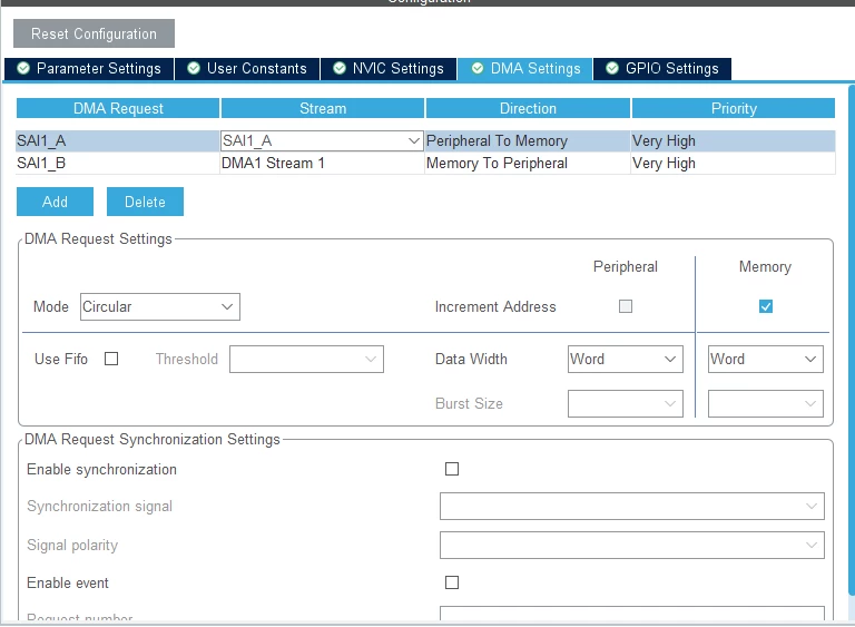

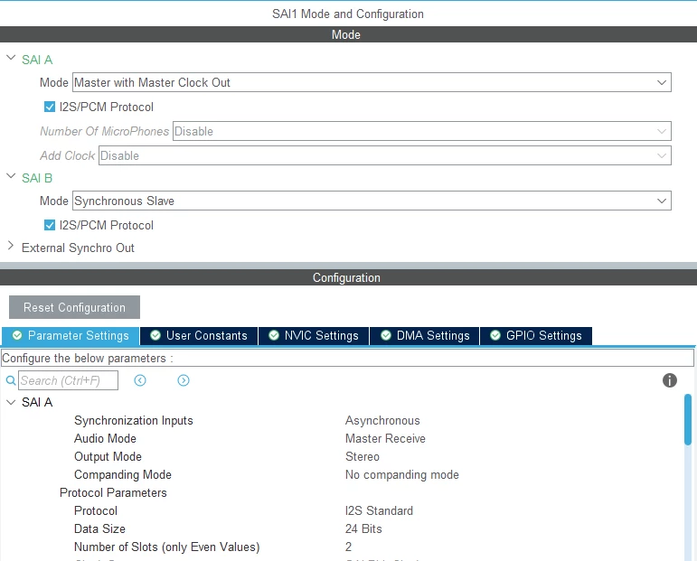

Does anyone have an idea what I am doing wrong?

Update:
I tested the exact same code on the STM32F439 with the SAI configured exactly the same way. Works perfectly fine, no issues. Therefore, I assume that this is definitely not a hardware issue and that the SAI is configured correctly.
