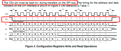

The User's Guide - https://www.ti.com/lit/pdf/swru295 - says that, after asserting CS, the SPI Master must wait for the CC1125 to pull MISO low before starting the transfer:
I think this means that the STM32F0's hardware SPI can't be used?

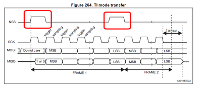

The CC1125 requires that CS remains asserted through the entire communication:
the CC1125 doesn't use the "TI protocol" described in the STM32F0 documentation:
(and that doesn't seem to cover waiting for MISO low anyhow)
