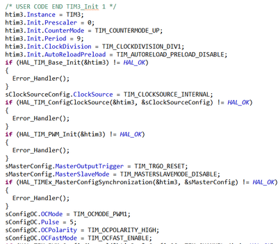

I am using the STM32H742 MCU.

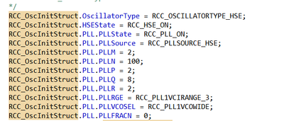

Currently, System CLOCK is set to 480 MHz and APB TIMER and AHB maximum CLK is set to 240 MHz.
However, the maximum frequency of TIMER and GPIO cannot exceed 25 MHz, so what should I do to make it over 50 MHz
Attached is the related code as well.

Why not? Set PSC (Prescaler) to 0 and ARR (Period) to 1 and the frequency will be 120 MHz if the timer clock is 240 MHz. Ensure pin frequency is set to VERY_HIGH.
max AHB clock is 120 MHz on this chip.

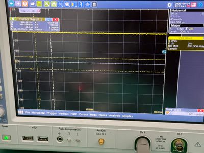

I set it like that, but the waveform appears as shown in the following picture
eogos
And I wonder why the cycle is at 25 MHz when I set the system clock to 480 MHz without timer and high/low it to gpio pin only. Gpio thought it would have a cycle of 240 MHz using ahb4bus.

Hello @eogos.
Switching the pin state does not fit into a single asm instruction, especially if it is wrapped in a function and speed optimization is not enabled.
To toggle the pin quickly, it makes sense to set up a timer function on one of the pins.
Here is my configuration for 48MHz with H753. The timer frequency is 240 MHz, and the pin is configured as TIM1_CH1. Every overflow pin toggles, so we have 48 / 2 = 24MHz output frequency on the TIM1_CH1 pin. You can get 30MHz toggling by decreasing period to 3, 40MHz by decreasing it to 2 and 60MHz by decreasing to 1. If you need 50, you should decrease timer clock from 240MHz to 200MHz for example, than set correct divider and period.
