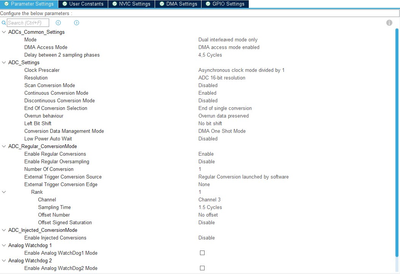

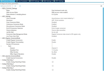

The following pictures show my setup for ADC1 and ADC2.
ADC 1 settings
ADC 2 settings

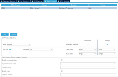

ADC 1 DMA settings

Hello @FBL ,
Thank you for your answer.
Could you share where I can find that information?
Best regards
Ersin
FBL
Hello @Ersin Kuscu
The transfer size is defined by the DMA_SxNDTR register value and by the peripheral side (ADC1) data width.
According to the reference manual, a stream has an independent 4-word (4 * 32 bits) FIFO.
To ensure that the last burst transfer is not incomplete, the total number of data items must be multiple of the burst size multiplied by the data size.
For more details, you can either check the reference manual 15.3.12 Programmable data width, packing/unpacking, endianness, or Using the STM32F2, STM32F4 and STM32F7 Series DMA controller
