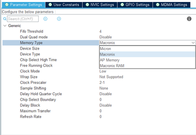

I am trying to connect the Quad-SPI Flash "SST26VF064B" to my MCU STM32H733ZGT6. I followed the tutorial provided by ST on YouTube (The Video calls "MOOC - External QSPI loader how to"). When I use the function HAL_OSPI_AutoPolling(), I get "HAL_ERROR" as return value, which leads into Error_Handler(). The code that causes me the error looks like this:

1st Question: Am I using the sCommand and sConfig structures correctly? What could be the cause for the HAL_ERROR return value?
2nd Question: When configuring CubeMX I noticed that I have to specify the memory type. The flash I use is from the manufacturer "Microchip". This is not listed in CubeMX. Which memory type should I select (see picture below)?

Hello @Moe ,
When using the QSPI mode, if the memory supported the Octo-SPI interface, any memory type can be chosen. The functionality of the QSPI is not affected by the memory type used. This behavior is mentioned in AN5050 and precisely in OCTOSPI configuration and parameter settings Section " 2. The memory type has no impact in Quad-SPI mode".
I recommend when configure the OCTOSPI interface to get inspired from the OCTOSPI application examples shared in AN5050. I hope this help you!

Hello @Moe ,
The Device Size configured in STM32Cube MX indicates the size of the OSPI memory in bytes and expressed in 2^n. For this memory type the Device Size should be 23.
Could you please check the OCTOSPI clock frequency, for that I advise you to refer to Table 76. OCTOSPI characteristics in SDR mode and Table 77. OCTOSPI characteristics in DTR mode (no DQS) in the datasheet .
Note that the OCTOSPI clock frequency depends from the VDD and CLOAD.
I hope this help you to solve the issue.

I have now reduced the OCTOSPI frequency to 20 MHz and also adjusted the device size, unfortunately the problem is still there. however, I have found something else curious:
In my firmware I use the HAL_OSPI_Command command several times and every time I execute it I could measure activity on the SPI bus with the oscilloscope. In the program snippet I posted (see my first post), I use the HAL_OSPI_Command there too butI notice that no SPI activity can be measured. What could be the reason for this? Is there any register of the OCTOSPI which I should look at?
