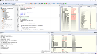

‎2024-05-13 8:35 AM
Hi @florent_b
I had made a simple test on H745 disco board and I can see the timer counter is triggered as expected.

‎2024-05-13 8:35 AM
Hi @florent_b
‎2024-05-13 8:38 AM
thanks for your testing!
But it is not what I want to do : I would like to have the timer count on PCLK clock as usual, and trigger the capture when the USB SOF event happens. So as to automatically timestamp the SOF instant.
Thanks,
Florent
