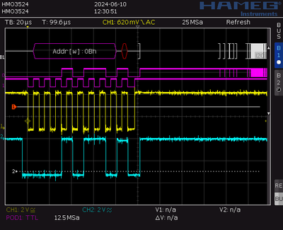

I'm currently working on an STM32 project where I want to communicate with an SMBus-compliant battery (address 0x0B) using I2C. I'm using an STM32F105 microcontroller and I'm setting up I2C on GPIO pins B6 (SCL) and B7 (SDA). I've encountered some issues and would appreciate some help.
  • I am using OpenDrain for SDA and SCL with a 1k external Pullup
  • The I2C address is being sent out, but the slave device (battery) doesn't respond correctly.
  • I have observed that the device is trying to pull down the SDA signal for an ACK, but it fails to do so consistently. This makes me suspect an issue with the pin configuration or the electrical setup.
  • Consequently, the error Interrupt throws Acknowledge Failure (AF),.

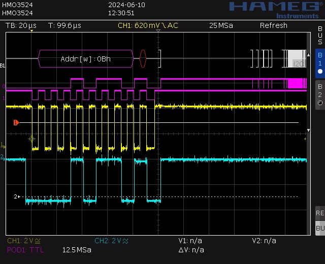

  • I observe that the battery attempts to pull down the SDA line, but it fails.
  • Note the tiny drop in voltage where the ACK signal should be sent.
  • Also note, that this drop is not present when I send to another address. So seems to be a response attempt by the battery.

1k pull-up seems too low. Maybe the slave can't pull SDA line low?
Try using a 4.7k instead.
