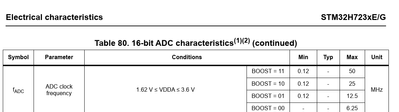

I checked the H725 Data sheet and the ADCs are limited to 50 and 75 MHz. Check the H723 data sheet for maximum ADC frequency.
4 REPLIES 4
raptorhal2
Lead
50MHz max.
see:
Thanks for pointing this out, CubeMX did allowed me to config it for 100MHz, while adding divider helped and now it's working ! I even did not checked it for clock, since 100MHz does not look too high and code was generated by software that does indicate values out of spec.
