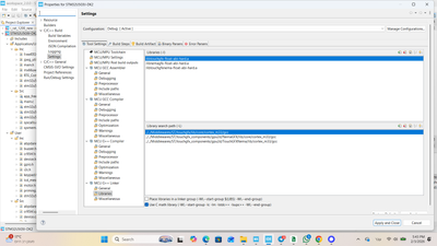

I generated my project from the TouchGFX envinroment.
Itried to modify the cube file and i got the following issues
1. linking error ld.exe: cannot find -l:libnemagfx-float-abi-hard.a: No such file or directory
2. linking error ld.exe: cannot find -l:libtouchgfxnema-float-abi-hard.a: No such file or directory
3. many basic files are missing like main.h so i cant access any gpio by the name that was given to it in my user files

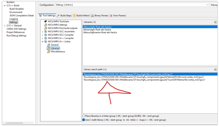

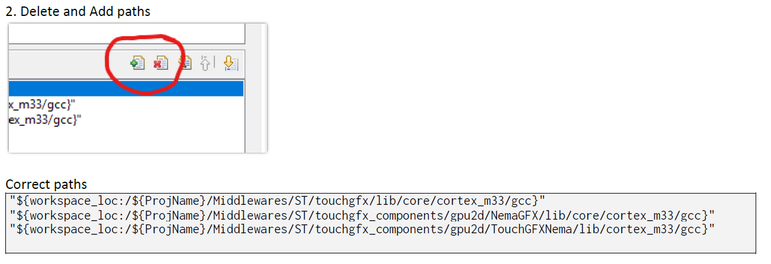

Hi @Ofer
Your linker lib search paths might be wrong. Try to tinker with following settings
"${workspace_loc:/${ProjName}/Middlewares/ST/touchgfx/lib/core/cortex_m33/gcc}"
"${workspace_loc:/${ProjName}/Middlewares/ST/touchgfx_components/gpu2d/NemaGFX/lib/core/cortex_m33/gcc}"
"${workspace_loc:/${ProjName}/Middlewares/ST/touchgfx_components/gpu2d/TouchGFXNema/lib/cortex_m33/gcc}"
2026-02-03 7:52 AM
thank dear Ferro but it seems to me my settings are exactly like yours but i get those errors

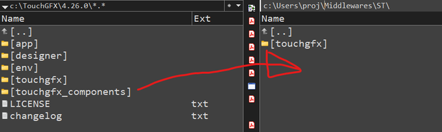

2026-02-07 4:53 PM - edited 2026-02-07 4:54 PM
Try to copy folder
c:\TouchGFX\4.26.0\touchgfx_components
into your project folder
<your\project\path>\Middlewares\ST\
