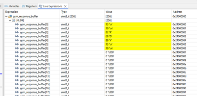

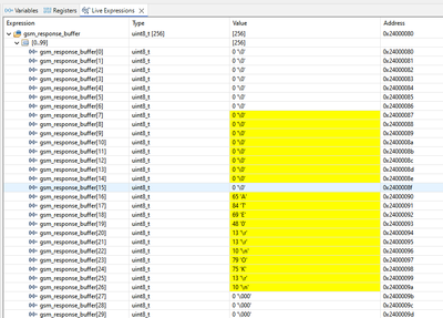

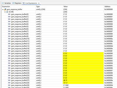

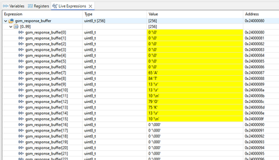

Hello ST Community,
I am working with STM32H750VBTx on STM32CubeIDE. I use UART7 + DMA with HAL_UARTEx_ReceiveToIdle_DMA()
to receive responses from a GSM modem.
Problem:
- GSM responses are stored in my gsm_response_buffer[] incrementally
- For example: first "RDY", then "AT OK", then "ATE0 OK" → all get appended
- I expected each new DMA reception to start at buffer[0].
Debug screenshots are attached.
Could you please advise how to properly useDMA reception so each new response starts from
gsm_response_buffer[0]?
Thanks in advance!

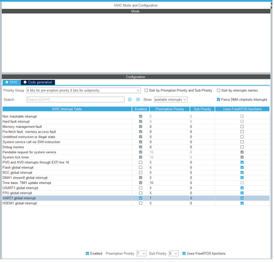

these are my ioc settings

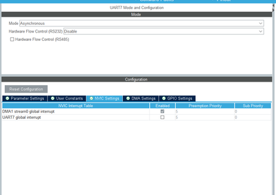

You were right the HAL_UARTEx_RxEventCallback was not getting called at all in my previous setup.
Even when i was receiving data from the GSM module.
without the global interrupt the
HAL_UARTEx_ReceiveToIdle_DMA(&huart7,
gsm_response_buffer,
GSM_RESPONSE_BUFFER_SIZE);
__HAL_DMA_DISABLE_IT(&hdma_uart7_rx, DMA_IT_HT);
call only ran once and it continued to receive the RX data.

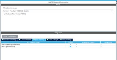

i did this now it works *.
i enabled the UART7 global interrupt
and also increased it's preemption priority to 7 from 5
* well in a weird way the replay from the gsm module is getting received sometimes

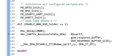

Another weird thing i noticed was when i ran the code without any breakpoints i got no replay from the RX line.
but when i debug with breakpoints i put one on the call
HAL_UARTEx_ReceiveToIdle_DMA( &huart7,
of /* USER CODE BEGIN 2 */
when i do this the responses came.
Now i put a delay as shown below and it worked!
```c
MX_GPIO_Init();
MX_DMA_Init();
MX_USART1_UART_Init();
MX_UART7_Init();
#if (ENABLE_006_GSM_Folder == 1)
HAL_Delay(2000);
#endif
Does anyone know why is this so?

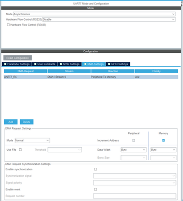

There is two ways you can go about fixing it.
  1. Don't enable Circular Mode. But you'll have to call HAL_UARTEx_ReceiveToIdle_DMA after you save your data to another buffer.
  2. You can keep Circular mode enabled, but you'll need to save your packets in a queue so that you can parse in main while loop while still receiving more packets. https://github.com/karlyamashita/Nucleo-G071RB_UART_DMA_Idle_Circular/wiki

Currently my problem got resolved by putting a delay after the initialization code.
I don't know why is this happening, if you know please inform me.
