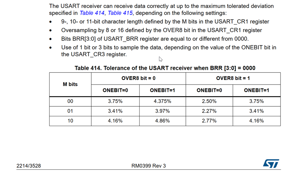

Uart's receive abilities relate to the clock deviation: see RM0399 reference manual.
https://www.st.com/resource/en/reference_manual/rm0399-stm32h745755-and-stm32h747757-advanced-armbased-32bit-mcus-stmicroelectronics.pdf
0693W00000QL9llQAD.pngYour uart clock is generated throug a PLL, is your PLL operating within its frequency spec (see my post of yesterday). If not it can be unstable. (If are you using MX configurator, then illegal configurations turn red).

@Johi​  makes excellent points:
"Uart's receive abilities relate to the clock deviation"
Indeed; and that may be different on each side - the MCU's receiver is not the same as the PC's receiver.
