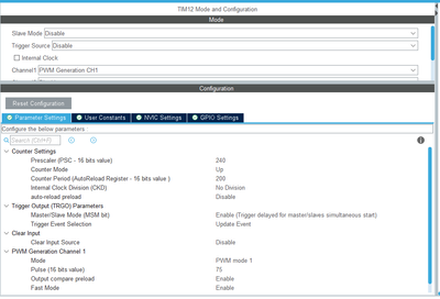

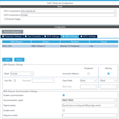

I am trying to generate a pulse-triggered waveform continuously by using DAC and DMA in STM32H735RGV6. To do this, I have opened DAC OUT1 with the following configuration.

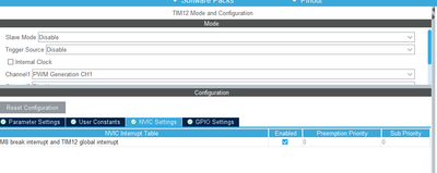

After that, I set up the TIM12 with the following configuration and expected that the DAC output would be synchronous with the timer but I got nothing out of the DAC.
I am not sure about that I have done all the necessary things. I need help from the one who did the same thing or has the information on DAC synchronization with a timer pulse.

I am also producing a PWM signal to check that the timer is running. I can see that there is no problem with producing the PWM signal. I suppose that the timer is running.
Ersin Kuscu
TIM12 Timer settings

This is the relevant code for the DAC DMA start.
HAL_DAC_Start_DMA(&hdac1, DAC1_CHANNEL_1, triang_val, N, DAC_ALIGN_12B_R);
Where triang_val is a triangular waveform.
If I do not use DMA request synchronization I can see the waveform on oscilloscope perfectly.
So probably the issue is your sync signal, TIM12_TRGO. You haven't shown any code related to that. What is configured as the TIM12_TRGO signal?
Exactly, I have configured DAC and DMA for TIM12_TRGO synchronization request but I didn't type any code to route TIM12_TRGO to DMA. Could you share a reference or an example of how to do that?
