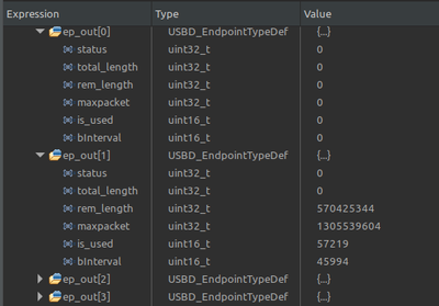

We have a problem where a certain call of memcpy overwrites/corrupts memory elsewhere, but this seems to not be a simple case of overflow since the place that gets corrupted is before the destination, i.e. the address's value is lower, i.e. 'behind' instead of 'ahead'. Furthermore, when I look at the values of all the relevant parameters and even the registers at the assembly-level, everything seems to be within bounds and in order.
The context of the memcpy is that we are copying bytes of a custom protobuf packets from the USB RX-buffer in CDC_Receive_HS callback to our own FIFO ring-buffer.

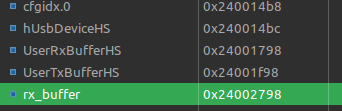

What happens is that the memory at 0x2400162c, which happens to be hUsbDeviceHS.ep_out[1].rem_length, begins to get corrupted and keeps corrupting all the memory from then onwards, right down to some important variables in rx_buffer that break the code with a hard fault. It seems that the corruption is endless as, if it wasn't for the hard fault, it would keep going to the bottom of the .bss section, and maybe even to that of whole D1 region.

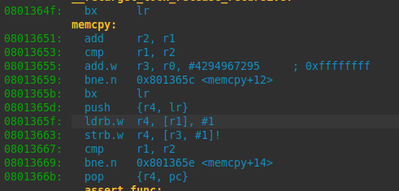

After I set a watchpoint on 0x2400162c, I found what line of code was corrupting the data, but it is still confusing as to why. The line of source in question is:
memcpy(&rx_buffer.data[rx_buffer.back], &Buf[0], *Len);
in the CDC_Receive_HS callback where
  • rx_buffer.data is a 2048 byte long array,
  • rx_buffer.back is 1135,
  • uint8_t* Buf and uint32_t* Len are arguments of the callback,
  • and *Len is 113.
Everything seems to be within bounds. The exact line of assembly is:
08013662 strb.w r4, [r3, #1]!
where
  • r4 is 0xef,
  • and r3 is 0x24002c06, which points to rx_buffer.data[rx_buffer.back].
So far, this seems to be the storing half of the memcpy, and everything again seems to be in bounds.

Furthermore, I am pretty sure that this break at the watchpoint is the event of corruption since when I continue the debugger (F8), it keeps hitting the watchpoint, and .rem_length (which is uint32_t) accumulates bytes in little endian order (the corruption seems to be byte-wise) until all four bytes are overwritten and it then hits the hard-fault breakpoint where the corruption has continued past to everything afterwards. I even put watchpoints at variables a bit further ahead to confirm the behaviour. So, it does not seem to be legimate writing of the .rem_length member.
The corrupting data also seems to be random-like garbage, not the bytes of our custom packet which has a lot of repetition and 0x00s. Sometimes, the first byte that corrupts 0x2400162c is either 0xa1 or 0x5e following a varying string of 0x00s. So, sometimes the location gets filled as 0x...a100, 0x...a10000, 0x...a1, etc. I have not played around much to tell how consistent this is.
Also, as an aside of the IDE, when I scroll up on the Disassembly view where the watchpoint has been hit, the blue arrow disappears and the address next to the strb.w line changes from 08013662 to 08013663. So, not actually sure where the watchpoint is hit. Also, in one of the attachments, see how there is a push two lines above. At first, I thought that the stack was overflowing there, but the stack-pointer was 0x2407fb60, well within the ._user_heap_stack.

  • watch the stack usage (with "coloring the stack"), check the "memory layout": is something before the stack damaged? Do you find a register set to a wrong memory address? (esp. after an INT has interrupted)
