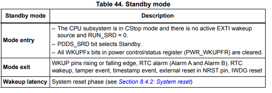

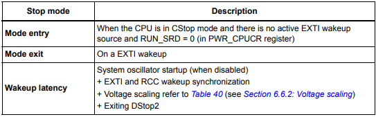

2) Check the table in your product ref man for mode exit:
0693W00000aI9VDQA0.pngYou may also need to read the Low power mode paragraph in ref man.
Hope that helps a bit!
Hello Sarra,
Sorry, I must have misunderstood. I thought that exiting Stop mode would generate a system reset too. That may not be ideal then.
If that's the case, then Standby would be more ideal, as I would like to start fresh when exiting the stop/standby mode.
Can any pin configured to a GPIO EXTI pin be used to exit standby mode?
After waking up from Standby mode, the program execution restarts in the same way as after a system reset (boot option sampling, boot vector reset fetched).
The system exits from Standby mode when an external reset (NRST pin), an IWDG reset, a WKUP pin event, a RTC alarm, a tamper event, or a timestamp event is detected
