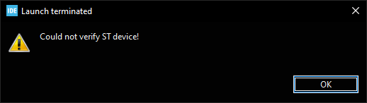

When trying to do a debug session onto these different STM32H7 devices:
  • STM32H743IIT6 / STM32H753IIT6
  • STM32H7A3IGT6
we are receiving the error
0693W00000QKUdHQAX.pngwith the following console statements:

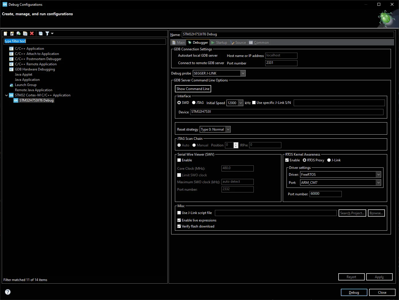

We are able to connect most of the time, but there are times when we have to re-start the debugger 5+ times of getting this error before it will finally attach. We have tried a Segger J-Link Base / Plus / Pro and all exhibit the same issue. We have also tried different programming speeds (console captured w/ 12000khz)
Is this an issue on Segger's side, or is this an issue with STM32CubeIDE trying to verify the ID of the STM?

Yes, i have just tried it with an ST-Link V3 and it has not experienced the same issue. I was able to Terminate and Relaunch 10x with no issue.
Have you tried a different debugger/programmer; eg, Segger's own tools?
Yes, and it connects just fine every time using Segger J-Link Flash / GDB Server... however, if used in conjunction with STM32CubeIDE, the IDE cannot always connect (Sometimes it will, sometimes not)
Pavel A.
July 6, 2022
IIRC this issue was already mentioned here. CubeIDE does not work well with some J-LINKs or some firmware versions, or only with certain MCUs ?
