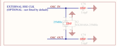

In the schematics HSE crystal is not fitted:
and in your clock config you set HSE to 24MHz as an external clock source. Did you solder that 24MHz crystal with its respective capacitors?

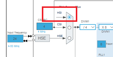

‎2024-06-12 6:33 AM - edited ‎2024-06-12 7:39 AM
Hi again,
Just noticed that your RCC clock source is set to HSI (64MHz) in your ioc file:
Could you please confirm/check?
‎2024-06-12 7:43 AM

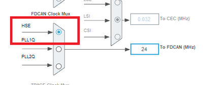

Sorry: Discard my previous comment about HSI clock source in your ioc file as your FDCAN clock source is HSE:
So please tell if you've already soldered a 24MHz crystal with its respective capacitors!
‎2024-06-12 9:32 AM - edited ‎2024-06-12 9:43 AM
No I havent soldered anything yet on the Nucleo board. I dint really think HSE would require me solder anything on the nucleo board... My Apologies!!

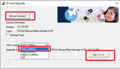

‎2024-06-12 9:59 AM - edited ‎2024-06-12 10:12 AM
Ah! How the FDCAN is clock sourced if there was no clock source then ;) ?
As per your ioc file FDCAN clock source is HSE and there is no external clock source!
I suggest to set the clock source in Bypass mode and
Use STLINK-MCO output as clock source for the system clock and select one of the PLLs output for FDCAN clock source.
For this you need to download ST-LINK firmware upgrade tool from here: https://www.st.com/en/development-tools/stsw-link007.html
connect to ST LINK and select one of the STLINK-MCO HSE clock source (to select 8MHz as external clock) as indicated in the following figure:
I propose you that clock config with a FDCAN timings at 500kb/s (ioc in attachment)
