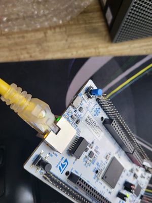

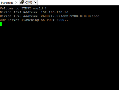

‎2025-06-12 3:42 AM
Hi @Andrew Neil , @STackPointer64 ,@mÆŽALLEm
We have checked on your all procedure to enable the Ethernet in the STM32H753ZIT6 NUCLEO-H753ZI (Development Board) with your reference, but the model and type is different(as per your reference).
Carefully we have checked all the settings, But still its not working, we have attached our working files and serial Output. Seeking your support in this matter.

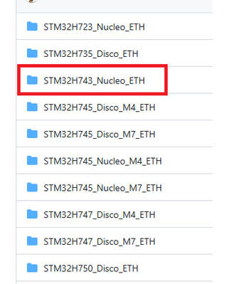

‎2025-06-12 4:03 AM - edited ‎2025-06-12 4:07 AM
If you mean by that you are using NUCLEO-H753ZI while that board is not available in the github.
You can use NUCLEO-H743ZI

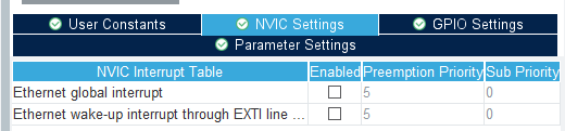

‎2025-06-12 6:30 AM
Hi @mÆŽALLEm
We have verified your example project (STM32H743_Nucleo_ETH) for connecting Ethernet to the NUCLEO-H753ZI development board.
But still its not working, we have attached our working files . Seeking your support in this matter.
‎2025-06-12 6:54 AM
Hello @Ematic,
It appears you changed the preemption priority but forgot to enable the ethernet interrupt itself.
Best regards,
