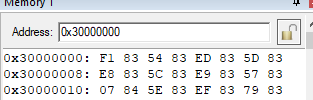

HAL_DMA_Start(&hdma_adc1,(uint32_t)&ADC12_COMMON->CDR ,(uint32_t)0x30000000, 6);      // Start DMA.
0693W00000Y9AOMQA3.png0x83F1 is the first ADC result at 0x30000000 and 0x30000001.
0x8354 is the second ADC result at 0x30000002 and 0x30000003 so on.
So, DMA works well when D-cache is enabled. Then I would like to define a variable at 0x30000000 as follows:

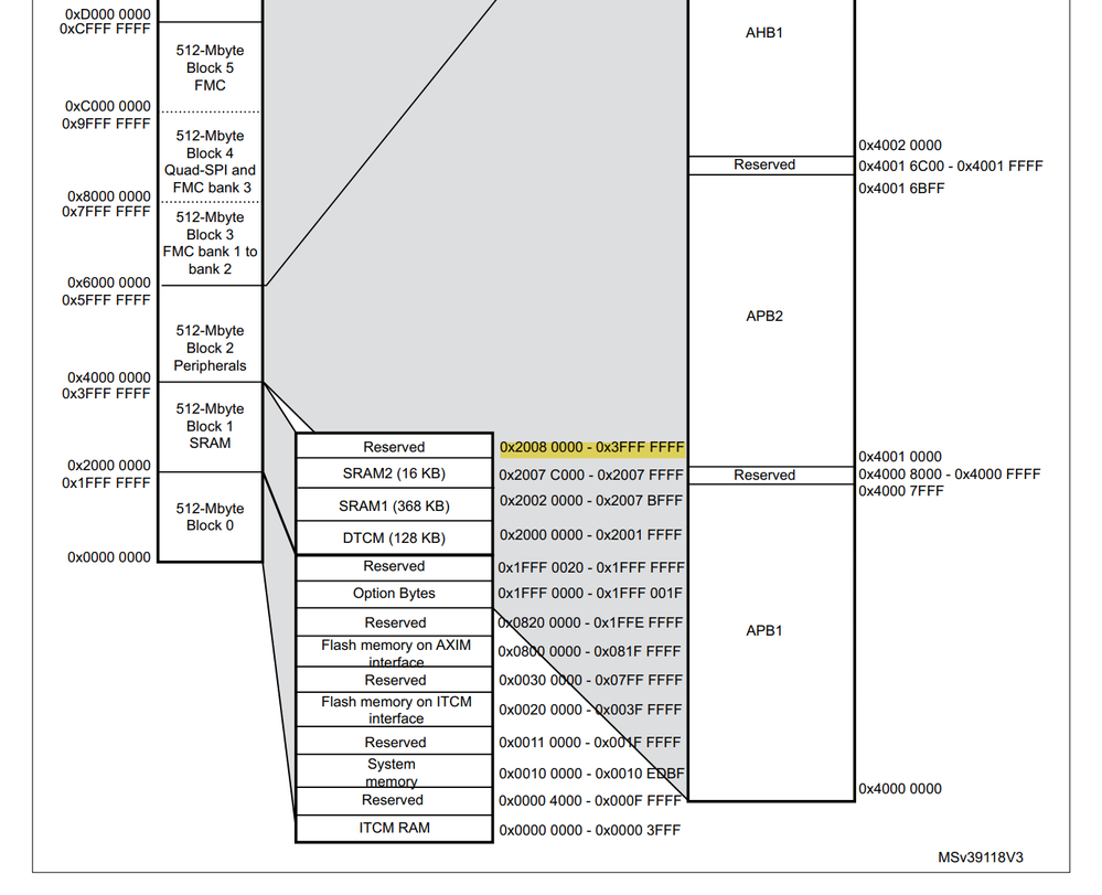

Hi @TA​ ,
Could you please be more specific about the product you are using? IOC file if possible would help.
To start the conversion process, you may use
 HAL_ADC_Start_DMA(&AdcHandle (uint32_t*)&uhADCxConvertedValue, 1)
instead of
It is important to note, in case of using an F7, that you are trying to access a reserved memory ! as mentioned in figure below which is not the case for an H7 for example, So you should try 0x200000C4 for example.0693W00000Y9DmCQAV.png
You may refer to the example provided on F7 using DMA while enabling DCache.
Hope this helps
Firas
To give better visibility on the answered topics, please click on "Best answer" on the reply which solved your issue or answered your question.Best regards,FBL
