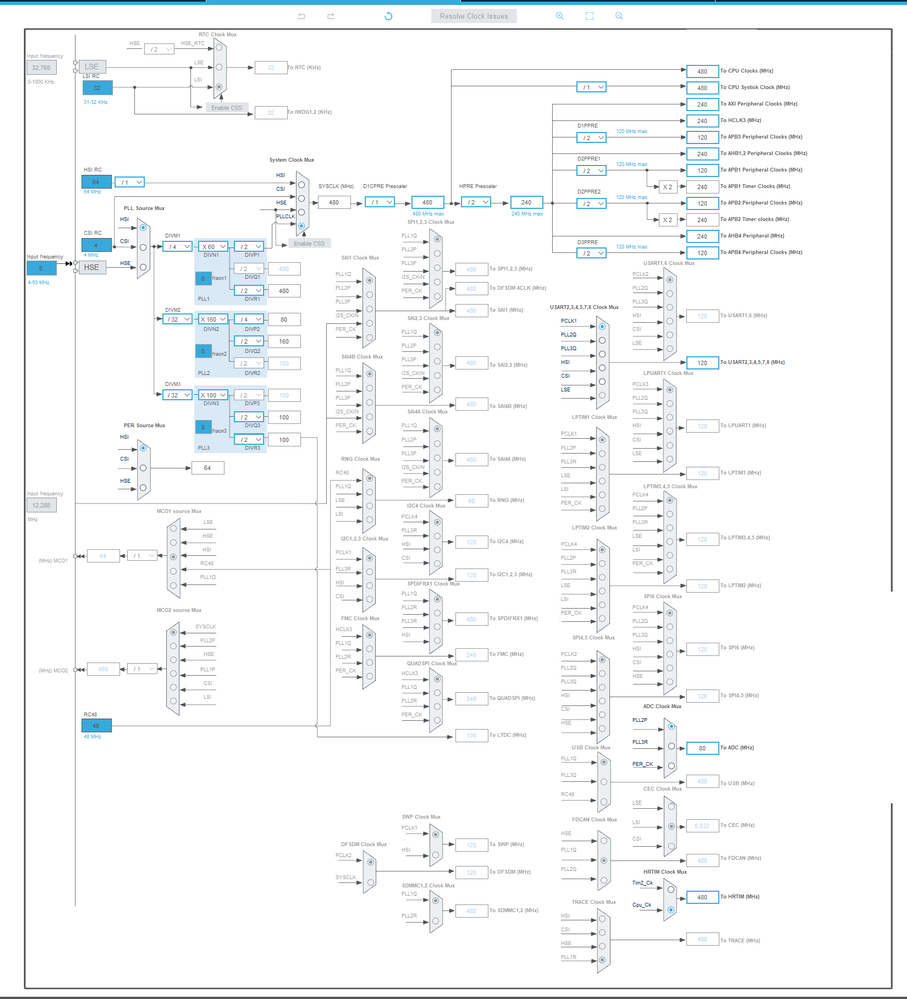

I programmed 480Mhz at the micro and 80Mhz at the ADC clock as can be seen here:

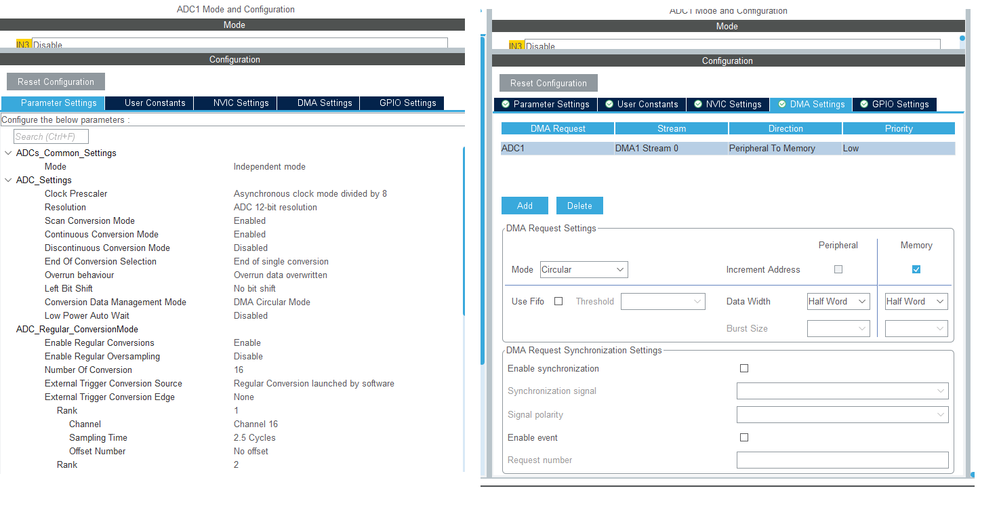

Also I programmed all ADCs in the same way. ADC prescaler was divided by 8 to have 10Mhz that is recommended for slow ADC channels, and the Rank1-N are set to 2.5 cycles to have 2.5+7.5=10cycles so have 1us/conversion as recommended:

The problem was the debugger: it is not posible to navigate from a DMA to other because DMA not stops in a breakpoint, so if there is a problem is better to make an only one breakpoint and test that DMA after an stop.
Now I have 2.35LSB error in 12bit adc3 at 1Mhz and 0.94LSbs in ADC1
