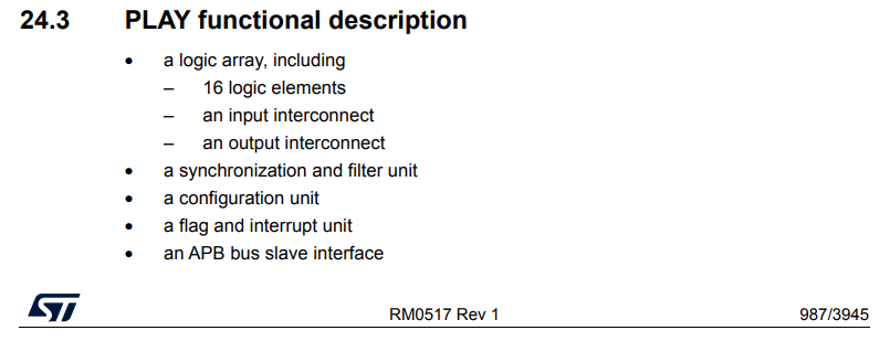

A new STM32 sub-family (as part of the 'H5 family) came out. They have everything but the kitchen sink. As far as I can tell, 'H5E4 and 'H5E5 differ only in that the higher one has USB-HS with PHY (the 'H5Fx are crypto-enabled variants, as usually)
What's new is also the PLAY peripheral, which is a small programmable logic element, fully documented and configurable through registers. It's based around 16 simple logic elements (4-input LUT and an optional register), complete with an extensive input multiplexer matrix+filter, interconnected to a variety of peripherals (timers, DMA, ADC...) and also GPIO.

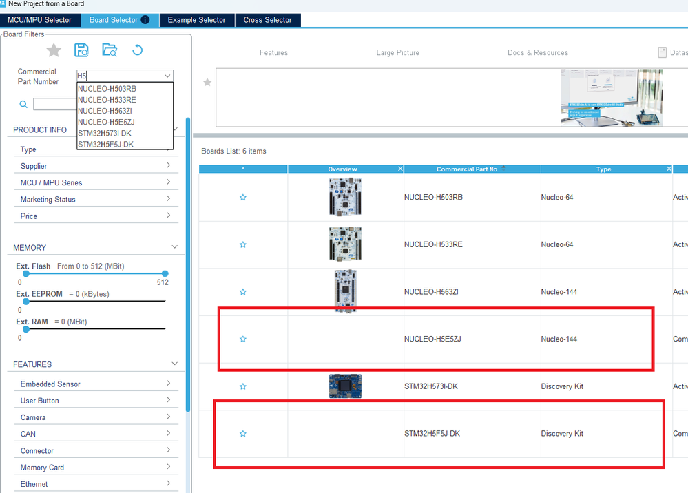

I wonder, if there's a Disco around...
mƎALLEm
There will be one Discovery board and one NUCLEO board ;).. Stay tuned.
You can use the latest version of CubeMx and use the board selector:

I don't see the PLAY mentioned on the STM32H5E4/5F4 or STM32H5E5/5F5 pages ?
PS
But I do see it in DS14972 (STM32H5Fxxx) and RM0517 (STM32H5E4/5F4 and STM32H5E5/5F5), both at Rev 1.
Haven't checked any others yet ...

mƎALLEm

It seems fairly simple - not sure it would warrant a simulator ... ?
https://www.st.com/resource/en/reference_manual/rm0517-stm32h5e45f4-and-stm32h5e55f5-armbased-32bit-mcus-stmicroelectronics.pdf#page=987
@unsigned_char_array wrote:
Is there a simulator for this? I'd love to play with it without hardware.
I'd love to try to generate custom waveforms, hardware acceleration for certain operators, custom communication peripherals, etc.
That's not a true FPGA, CPLD or similar device. It's just a lookup table that you could construct some logic block with.
