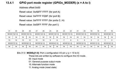

And what configuration do the GPIOs have then?
see rm:  (What they should do...except our story about PB14...so far... )
So (most) pins are at analog mode.
