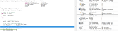

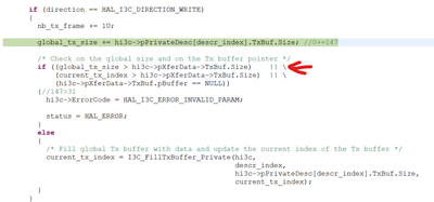

After running debug, the error occurs in "static HAL_StatusTypeDef I3C_Xfer_PriorPreparation()"
condition (global_tx_size > hi3c->pXferData->TxBuf.Size) will always be satisfied unless 'aTxBuffer[]' has more than 147 elements.

‎2024-06-19 4:40 AM
Hi Foued,
I tried the code that you suggested, and the system stuck in the same place.
I found out that 'global_tx_size' came from 'pPrivateDesc.TxBuf.Size', which was set at line 2167.
However, I think I fix this problem after this modification.
Before:
I3C_PrivateTypeDef aPrivateDescriptor[2] = \
{TARGET1_DYN_ADDR, {aTxBuffer, TXBUFFERSIZE}, {NULL, 0}, HAL_I3C_DIRECTION_WRITE},
{TARGET1_DYN_ADDR, {NULL, 0}, {aRxBuffer, RXBUFFERSIZE}, HAL_I3C_DIRECTION_READ}
After:
{TARGET1_DYN_ADDR, {aTxBuffer, 1}, {NULL, 0}, HAL_I3C_DIRECTION_WRITE},
{TARGET1_DYN_ADDR, {NULL, 0}, {aRxBuffer, 1}, HAL_I3C_DIRECTION_READ}

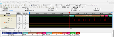

I could capture a waveform as below:
Q1:
That modification make the system can only send 1byte of data.
Could you provide a better solution?
Q2:
It seems that the system successfully transmit a data (0x20), but why?
Shouldn't the expected value of this data be 0x0F?

‎2024-06-21 2:41 AM
Hello @SteveDu ,
1/ You can modify the size of the Tx buffer and the Rx buffer to receive more data.
2/ Could you check the datasheet of your device ( I3C target ) for more details about registers ?
Foued
