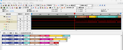

Capture1 is the result of "I3C_RSTDAA_THEN_ENTDAA"
The expected behavior of Capture1 should be 7E06 then 7E07.
Why would 7E02 occur along with a write error?

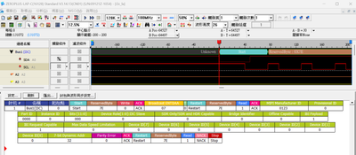

Capture2 is the result of "I3C_ONLY_ENTDAA"
My questions are:
1. I'm wondering where is the code that define the configures in color green.
2. Is it able to modify their values?
3. Is it a successful ENTDAA process?

3.Capture2 is good result of dynamic addressing.

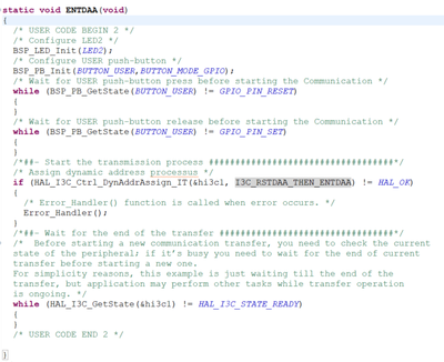

1. Still wondering whether the waveform in Capture1 matched the expected behavior of the code below.
if (HAL_I3C_Ctrl_DynAddrAssign_IT(&hi3c1, I3C_RSTDAA_THEN_ENTDAA) != HAL_OK)
/* Error_Handler() function is called when error occurs. */
 Error_Handler();
If not, please help me to fix this problem.:folded_hands:

1/ could you please the section 4.1.1. Interrupt mode in the WIKI : Getting started with I3C - stm32mcu
