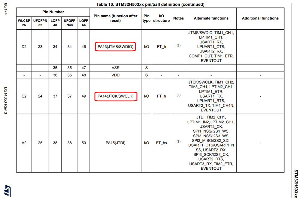

@Ravichandran wrote:
when configuring GPIOs in PORT A and integrating it with data pulses, the following error occurs stating the target device not responding.
The SWD Debug pins are on Port A:
Therefore, if your "configuring GPIOs in PORT A" includes PA13 and/or PA14, then that is going to break the debugger connection.
We've filtered out pins that we can't use and are left with only 5 pins namely PA0, PA1, PA2, PA6 and PA15. We have rejected PA3 since in our EVM Nucleo 64 MB1814B, it is configured as UART/USART as default. Remaining pins we've rejected since they are not 5V tolerant
And you're sure you're not messing with PA13 and/or PA14 ?
If we change the pins to PORT C (P0-P3), it works as intended.
Which very much suggests that you are disturbing the debugger connection!

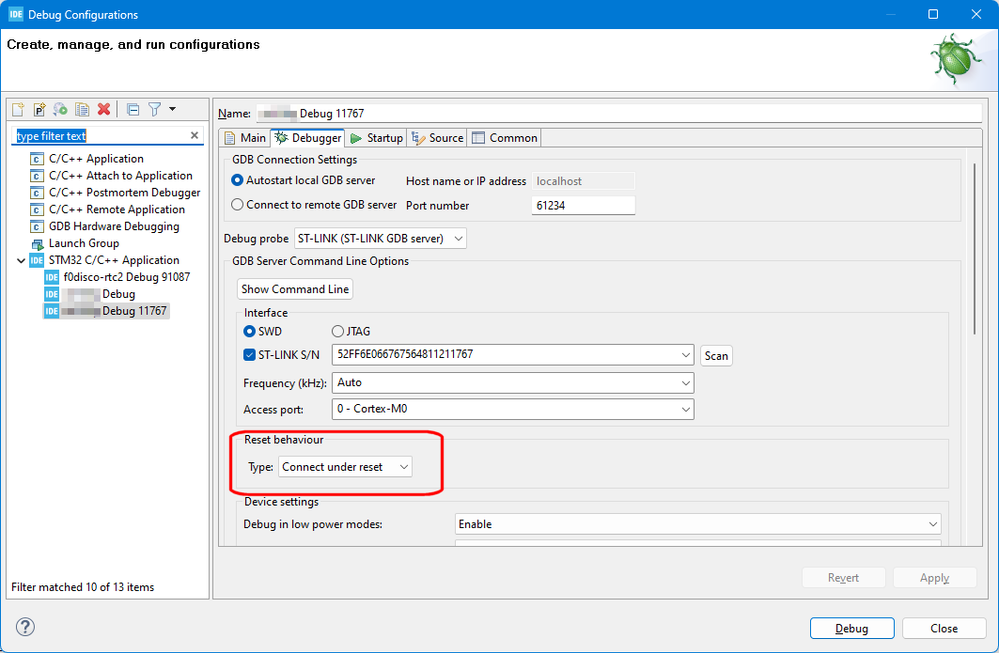

Do you connect under Reset?
Can you kindly explain what you mean by connecting under Reset so that we can understand.
https://community.st.com/t5/stm32cubeide-mcus/debug-configuration/td-p/281735
Ravichandran
Yes Andrew, we have been using that debug configuration
