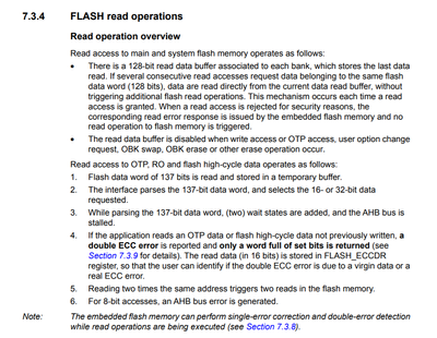

Also, have a look on our Reference Manual on the way, we read these Areas : OTP, RO and High Cycle Data - EDATA.
Hope it is helping.
