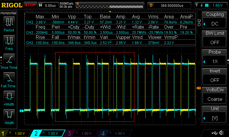

I've still haven't found a solution to the HRTIM ADC Trigger, but I've managed a workaround in calling the LL_ADC_REG_StartConversion inside TIMER B HRTIM_TIMB_IRQn_IRQHandler.
TIMER B is a dedicated UP-COUNTING timer, with CMP1 configured at 50% DutyCycle.
The workaround is functional, but not optimal, even if the TIMER B is "statically configured" the IRQ does not latch with a constant period, sometime pulses are skipped (TIMER B CMP1 is the only and highest IRQ).

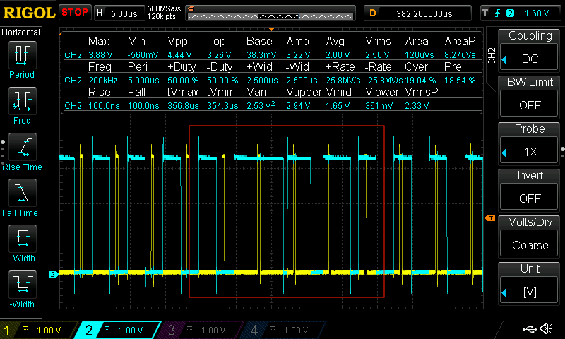

The ISR code to manage TIMERB CMP1, toggle of a pin (simulating ADC Triggering):
void HRTIM_TIMB_IRQn_IRQHandler (void) { //HRTIM_Master_IRQn_IRQHandler( void ){
// Code must check for a specific enabled flag
if( LL_HRTIM_IsActiveFlag_CMP1( HRTIM1, LL_HRTIM_TIMER_B ) == 1 ){
LL_HRTIM_ClearFlag_CMP1( HRTIM1, LL_HRTIM_TIMER_B );
vGpioAPI_Toggle(xGpioAPI_XMI_GPIO2);
Here follows the scope acquisitions of the issue, highlighted in red:
- in yellow is the CENTER ALIGNED PWM output of TIMER A, with a varying duty cycle
- in blue the vGpioAPI_Toggle(xGpioAPI_XMI_GPIO2) function, called inside the TIMERB CMP1 IRQ, with fixed 50% duty.

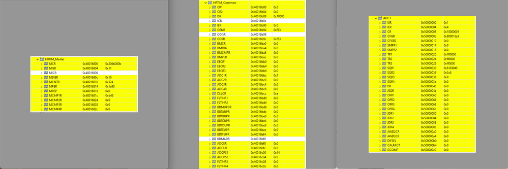

‎2022-01-28 7:33 AM
Hello Davide,
Attached is a snapshot of the HRTIM master, HRTIM common and ADC1 registers taken with a working configuration. It might help you to identify what is missing in your software. Note that as far as HRTIM is concerned, the configuration is pretty simple.
‎2022-02-03 1:26 AM
Dear @Francois VILMAIN​ ,
Thank you for your answer.
I've tried to replicate the configuration you've suggested but I still get an erroneous behaviour of the HRTIM peripheral.
That's my minima init of HRTIM, that results in the same Common & Master register configuration as indicated in your register snapshot.
HRTIM1->sMasterRegs.MCR |= 0x2001000B;
HRTIM1->sMasterRegs.MDIER |= 0x00000010;
HRTIM1->sMasterRegs.MCNTR = 0x00000000;
HRTIM1->sMasterRegs.MPER = 2*iInverter_PWM_Level;
HRTIM1->sMasterRegs.MCMP1R = iInverter_PWM_Level;
// a) CMP1 Tentative
LL_HRTIM_ConfigADCTrig(HRTIM1, LL_HRTIM_ADCTRIG_1, LL_HRTIM_ADCTRIG_UPDATE_MASTER, LL_HRTIM_ADCTRIG_SRC13_MCMP1);
// b) MPER Tentative
//LL_HRTIM_ConfigADCTrig(HRTIM1, LL_HRTIM_ADCTRIG_1, LL_HRTIM_ADCTRIG_UPDATE_MASTER, LL_HRTIM_ADCTRIG_SRC13_MPER);
// Postascaler
LL_HRTIM_SetADCPostScaler(HRTIM1, LL_HRTIM_ADCTRIG_1, 20);
On the ADC Side, EXTSE bits have the right pattern [10101], EXTEN have rising edge [01].
That is done by the following instructions:
// Enable the ADC external trigger
LL_ADC_REG_SetTriggerSource( ADC1, LL_ADC_REG_TRIG_EXT_HRTIM_TRG1 );
LL_ADC_REG_SetTriggerEdge(ADC1, LL_ADC_REG_TRIG_EXT_RISING);
If, instead of External, I configure the ADC to use the Software Trigger with "LL_ADC_REG_SetTriggerSource( ADC1, LL_ADC_REG_TRIG_SOFTWARE )", the acquisition pattern starts and complete without issue.
I believe my problem is that the HRTIM is not generating the TRG1 but I really cannot understand the reason. Attached you can find my registers snapshot: maybe you can spot the elephant in the room.
Thank you,
Davide
