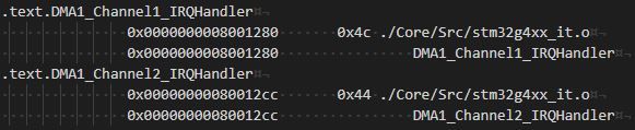

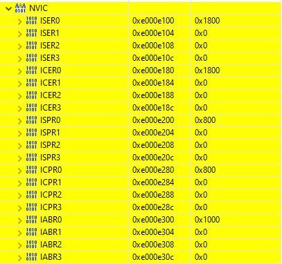

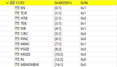

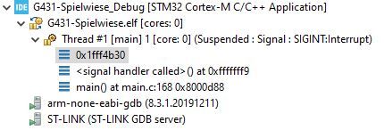

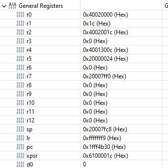

My problem is that the program hangs up at the wait for SPI transmission completed
// Wait for SPI transmission completed
while (TRANSFER_WAIT == tSpiTransferState)
The DMA interrupt handlers (neither channel 1 nor channel 2) are not called...
Nevertheless, if I halt the MCU, everything seems to be done correctly.

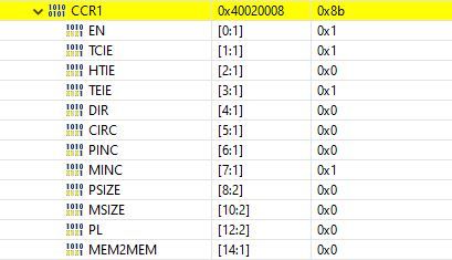

DMA channels are configured correctly (including the transmission complete interrupts enabled)
0693W00000JOcKcQAL.jpg0693W00000JOcLaQAL.jpgAnd the transmission complete flags on the DMA channels are set.

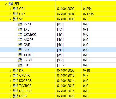

0693W00000JOcQQQA1.jpgAlso the SPI status register looks good.

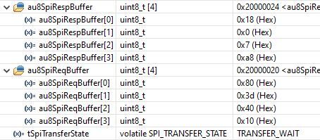

0693W00000JOcLpQAL.jpgAnd even the response buffer shows the actually received data.
0693W00000JOcQkQAL.jpgThe only strange thing is that the DMA interrupt handlers are not triggered...
Anyone with an idea what I'm missing?

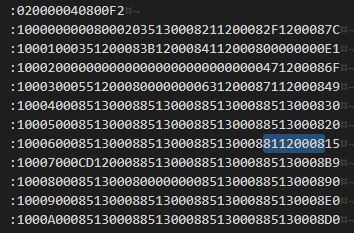

> What could be the reason, that in my application the bootloader will be entered?
I don't know. Check SCB->VTOR.
Check your BOOT0 pin and setting of the relevant option bits.
Check SYSCFG_MEMRMP.

Update: I confirmed that this is an interrupt issue.
If I just poll for the DMA transmission complete flags instead of using the DMA transmission interrupts, erverything will work as expected.
Any idea what avoids the interrupts to be triggered?
waclawek.jan

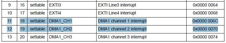

- interrupts not enabled in NVIC - read out NVIC registers to check
- current execution priority higher than interrupts' priority - incorrectly finished previous interrupt or incorrectly set up RTOS
 - globally disabled interrupts
Here is some general checklist.
StefanHogg
The interrupts are enabled in DMA initialization:
static void MX_DMA_Init(void)
  /* Init with LL driver */
  /* DMA controller clock enable */
  LL_AHB1_GRP1_EnableClock(LL_AHB1_GRP1_PERIPH_DMAMUX1);
  LL_AHB1_GRP1_EnableClock(LL_AHB1_GRP1_PERIPH_DMA1);
  /* DMA interrupt init */
  /* DMA1_Channel1_IRQn interrupt configuration */
  NVIC_SetPriority(DMA1_Channel1_IRQn, NVIC_EncodePriority(NVIC_GetPriorityGrouping(),0, 0));
  NVIC_EnableIRQ(DMA1_Channel1_IRQn);

This is also reflected by the NVIC registers
0693W00000JPAhQQAX.jpgAdditionally I call __enable_irq() before my main while loop.
What struggles me, is the set bit in NVIC register "IABR0" which means that an interrupt is active.
I've cross-checked the name of my interrupt handlers "DMA1_Channel1_IRQHandler" and "DMA1_Channel2_IRQHandler". They match the handlers which are embedded in the interrupt vector table of the file "startup_stm32g431kbtx.s" embedded in this project.
So everything seems to be correct for calling the interrupt handlers, but they aren't triggered...

> Well then probably it is. Where is the program counter?
The program counter is at 0x1FFF4B30.
0693W00000JPFS1QAP.jpg0693W00000JPFSBQA5.jpgWhat does this mean? It is not a "normal" program address...
> Never trust source code - processor executes binary, not the source code. Have a look at the vector table in binary and check that the proper vector is at proper position.
The interrupt vectors I'm interested in are at address 0x0000006C and 0x00000070.
0693W00000JPFSfQAP.jpgMy handler are located at addresses 0x08001280 and 0x080012CC (seen in map-file).
0693W00000JPFSuQAP.jpgIn the output hex file the interrupt vector looks like following picture.
0693W00000JPFT4QAP.jpgThe stored addresses in vector table are different by 1 compared to the addresses in map file. But I've checked that with other standard IRQHandlers like "HardFault_Handler" or "MemManage_Handler". There is the same difference, so from my point of view this seems to be ok.
waclawek.jan
Yes, the vector table is OK.
Cortex-Mx runs permanently in Thumb mode (see some basic ARM history/overview) and bit 0 of code addresses signalize this.
> PC=0x1fff4b30
This is in the system ROM area, a.k.a. bootloader. Check your BOOT0 pin and setting of the relevant option bits.
