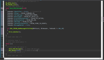

@mƎALLEm Didn't work but found something the the program freezes whenever I connect my USB To CAN analyzer. if not it is sending the DATA 3 times and then freezes maybe the TxFifo is getting filled
I have attached my main code other than that everything is from your setup. Thank you
int main(void)
  /* USER CODE BEGIN 1 */
  /* USER CODE END 1 */
  HAL_Init();
  /* USER CODE BEGIN Init */
  /* USER CODE END Init */
  SystemClock_Config();
  /* USER CODE BEGIN SysInit */
  /* USER CODE END SysInit */
  MX_GPIO_Init();
  MX_FDCAN1_Init();
  /* USER CODE BEGIN 2 */
  HAL_GPIO_WritePin(GPIOC, GPIO_PIN_13, GPIO_PIN_RESET);
  void Send_CAN_Message(void)
    TxHeader.Identifier = 0x444;  // Standard ID
    TxHeader.IdType = FDCAN_STANDARD_ID;
    TxHeader.TxFrameType = FDCAN_DATA_FRAME;
    TxHeader.DataLength = FDCAN_DLC_BYTES_12;
    TxHeader.ErrorStateIndicator = FDCAN_ESI_ACTIVE;
    TxHeader.BitRateSwitch = FDCAN_BRS_ON;
    TxHeader.FDFormat = FDCAN_FD_CAN;
    TxHeader.TxEventFifoControl = FDCAN_STORE_TX_EVENTS;
    TxHeader.MessageMarker = 0xAB;
    if (HAL_FDCAN_AddMessageToTxFifoQ(&hfdcan1, &TxHeader, TxData0) != HAL_OK)
      Error_Handler();
  /* USER CODE END 2 */
  /* Infinite loop */
  /* USER CODE BEGIN WHILE */
  while (1)
    /* USER CODE END WHILE */
    /* USER CODE BEGIN 3 */
	  Send_CAN_Message();  // Send CAN message
	  HAL_Delay(1000);     // Wait 1 second
	  HAL_GPIO_WritePin(GPIOA, GPIO_PIN_3, GPIO_PIN_RESET);
	  HAL_Delay(1000);
	  HAL_GPIO_WritePin(GPIOA, GPIO_PIN_3, GPIO_PIN_SET);
	  HAL_Delay(1000);
  /* USER CODE END 3 */
