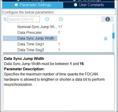

Yeah i used the Kvaser CANFD bit time tool but the values generated for the dataprescaler was not in the range
The DataSyncJumpWidth value is coming as 63
but stm32cubeide tells that it should be btw 1 and 16

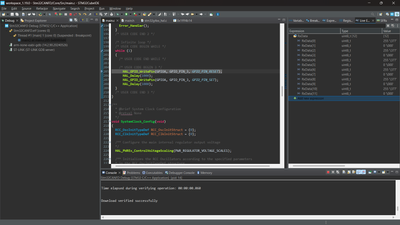

Seems it worked i guess the program entered the while loop also i can see the last TxData inside the Rxdata

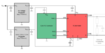

1- For Normal mode did you follow the schematic provided in the transceiver datasheet?
2 - What about both power supplies VCC and VIO? please check the power supply:
3 - What about the STB (Standby mode) voltage level? tied to GND? please do a continuity test with the tranceiver powred off.
4 - What about the terminating resistors 2x120ohm? did you connect them on both sides of the bus? one of them is present in the USB-to-CAN FD analyzer?

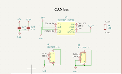

Yep i followed all the thing is the datasheet.
I connected the STB to a GPIO (PC13) to the STM32 and pulled it low programmatically.
*** I'm sorry seeing now  i haven't given the +5v it comes from the main supply through a buck and I've been giving only +3.3v from the STlink.
Can i now just change the mode to Normal Mode and keep everything else same and check again will you think it will work?
And yes i have a termination resistor in my STM32 board and one in my USB to CAN analyzer as well
1- You need to poser supply the tranceiver as following VCC=5V, VIO=3.3V
2- To me the schematic is OK. You need to ensure that STB pin is tied to the ground either externally or with a GPIO pin.
