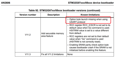

Have you checked STM32 microcontroller system memory boot mode, to see the difference between STM32G03 and STM32G07.
I'm trying to exit the STM32G07 USART bootloader by setting the nBoot0 bit in the Flash Option register.
I noticed in AN2606 in Table 92 that V11.2 of the STM32G07 bootloader shows the following issue: "Option byte launch missing when using USART protocol".
Do you have more information about this issue?
Could this be the reason that setting the nBoot0 bit via the USART on the STM32G03 exits the bootloader as expected, but setting the nBoot0 bit via the USART on the STM32G07 does not exit the bootloader?

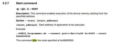

Maybe your steps isnt optimal. Why you dont use run command . This provide start application ability better.
In gui on CPU panel if i rememmber or
The STM32G07 does not have a USART bootloader "run" command (see AN3155).
Is there more information about the issue "Option byte launch missing when using USART protocol" that is mentioned in AN2606 in Table 92 and could this be the reason the STM32G07 is not exiting the bootloader when the nBoot bit is set in the Flash Option register?
Can someone who has actually read the question I posted and has used the bootloader via the USART and read the documentation (AN2606 & AN3155) please answer the question.
Ok i name it run but mean GO and i dont see any word about GO command not exist in ...
Is there more information about the issue "Option byte launch missing when using USART protocol" that is mentioned in AN2606 in Table 92 and could this be the reason the STM32G07 is not exiting the bootloader when the nBoot0 bit is set in the Flash Option register?
