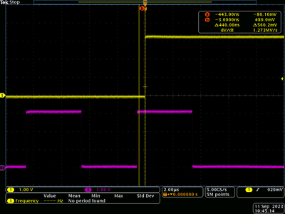

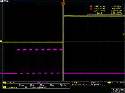

implementing a SPI master (NOT using HAL) with software based SS i am searching for the right way to detect the end of a transmission to release the SS again.
EOT (in SPI_SR) gets set when the last Bit is is set to the MOSI Lane.
--> so this is too early since the there is a full clock cycle remaining until SS should be reset.
Is there any Signal that could be used to know that the Transfer on the SPI BUS is full finished? Using the Hardwaree SS is working fine But since I have a multi-slave environment I would like to use software based SS.
dbahr
my current workadound is to use EOT as a trigger to release the SS and restrict the minimum speed that can be used on SPI.
YELLOW: NSS
RED: SCLK
125kbit/s (NSS is released too early):
1Mbit/s (NSS is released correctly):

Hello @dbahr
You can use th EOT and a clock cycle delay. EOT is set ->a clock cycle delay (using a TIM for example) ->release the SS again.
Best regards.

Your best option for this is the EOT signal.

In full duplex (bi-directional) mode, you can use the RX non empty flag. It means that all master bits have been completely clocked out and slave bits clocked in. When it set, SS can be turned off.
Hi, RX non empty Flag is also triggered too early. As I understand it is wordwise and not going 0 when the last bit is transmitted.
I think, in that case,my solution can give you exactly what you are looking for (signal EOT start TIMER and then the TIMER signal trigger the SS reset.

If you have control over slaves, try the other CPHA setting.
