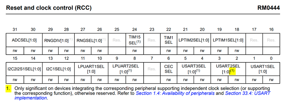

Hi
so I am trying to get the UART2 on my STM32G031K8Tx up and running. RefManual shows in Chapter 5.4.21 a CCIPR register (Peripherals independent clock configuration register), where bits 2-3 relate to the USART2.
When looking at the device specific header file for the STM32G031xx series, I cannot seem to find the USART2 peripheral clock. In fact, using the LL API from ST, I get a compilation error on the following line:
LL_RCC_SetUSARTClockSource(LL_RCC_USART2_CLKSOURCE_PCLK1);

I am not sure, but I suspect that the device specific header file does not match with the reference manual? Or what am I missing here?

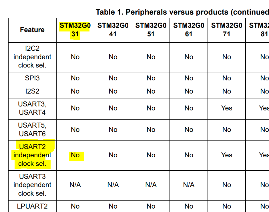

There is no clock configuration for USART2 on that chip so the USART2SEL field is reserved. There is a note saying it only exists on devices which implement independent clock selection:
And a further note saying STM32G031 is not one of them.
I would argue that the header file is correct not to include that field as it is reserved on that chip and that the real bug here is that CubeMX generates code that tries to access it.
