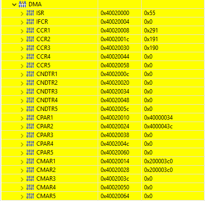

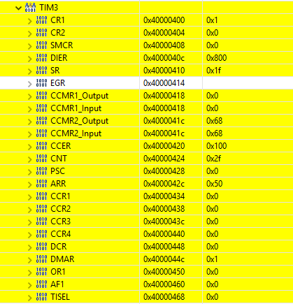

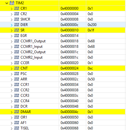

We're porting some existing working code to the STM32G031J6M6.
On pin 5, we are using TIM3CH3, and passing high time data from an 8 bit array to the 16 bit CCR3 register, and the waveform is as expected - correct.
On pin 4, we are using TIM2CH1, and passing high time data from the same 8 bit array to the 32 bit CCR1 register, and the waveform has the correct high time mixed in with one other pulse of variable length, and a much longer than expected period.
Is there any known issue with using TIM2CH1 for PWM Mode 1 on this device?
The SFRs for DMA, TIM2 and TIM3 are shown below.
4 REPLIES 4
waclawek.jan
Registers look OK to me.
Can't the problem be in how DMAMUX is configured?

I took a look at the DMAMUX, and ruled it out by writing a loop that updated the CCR1 register when the channel 1 flag was set in the SR. The result is the same.
The reaction looks as if the CNT register is sometimes not resetting at ARR, but is running to maximum and wrapping, then I get an edge on the next match with CCR1. Very odd.
waclawek.jan
Would that be the case, given TIM2 is 32-bit, that would take time in the order of 100 seconds (i.e. a couple of minutes). You should be able to observe that by repeatedly reading out the TIM regsiters' content in debugger.
Try reducing the program to bare minimum, and post it here with together with observed waveform and explain how exactly is it different from the expectation.

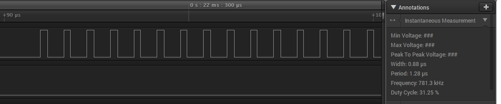

In the end, we have removed the TIM2CH1 code and used TIM3CH3 and TIM3CH2. TIM3CH2 is on pin8 of the device, which is why we avoided it originally, as it is assigned to SWCLK (luckily, we can work with testing most elements on TIM3CH3 only, leaving the part to run on TIM3CH2 also when it is off the debugger). On this channel, we are using DMA Ch1, and it generates the waveform below.
