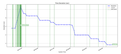

Here's example chart. dots - clock deviation compared to PC system clock; green lines - interaction with GSM module (AT commands and GPRS data transmission), red line (among bunch of green lines) - initial clock sync.

As I expected RX8130CE and MAX31343ETAY external RTCs work perfectly with near-zero time drift (less than 1 second per hour; they have no centiseconds so I can't tell real clock drift). It's an enough cheap solution - but I confused that internal RTC/LSE is so sensitive for EMI...
So I have a question: is LSE from other STM32 MCU series have same high sensitivity for EMI, or it's bug of STM32G0 series (and possibly some others with similar LSE schematic)?
