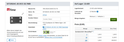

AScha.3
>Is there any option to make it stable in high-EMI environment?
Maybe do it  "my way" : dont use a crystal, use a oscillator;
today about same price as a good crystal + caps.
something like this:
...then check, if there still any influence from ext. radiation .
other "problem" with LSE internal osc. : if switching action on adjacent pins...
- so check, if you have any switching on pins next to LSE - pins .
oscillator costs same price as cheap RTCs with oscillator like RX8130CE, and consumes more power than RTC (there is backup 0.22uF supercapacitor for RTC, and oscillator may consume too much extra power).
