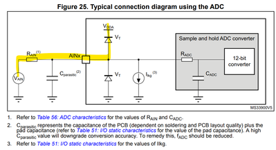

Just one last thing to be absolutely sure - where you said " 2.5V is maximum input voltage to ADC too" - this you mean the maximum volts to avoid ADC saturation, correct? But the pin can still withstand more volts as follows from datasheet:
I am using PA0 as the ADC input (ADC_IN0).
From datasheet (STM32G071RB) this is listed as FT_a IO structure.
My VDD and VDDA  is 3.3v
Under 5.2 absolute max for FT_xx is VDD+4 so 7.3
Under 5.3.1 FT_a has a max of min(vdd+3.6,5.5) so min(3.3+3.6,5.5) = 5.5
So if I design my current sensing region of interest to max out at 2.5v if a higher current happens and puts PA0 pin above 2.5v but below 5.5v the only result is ADC saturation and not chip explosion.
Thank you once again
That's correct as far as I can see.
There are protection diodes in place. I suspect the following figure is simplified, but shows the general scheme.
Personally, I wouldn't want to design something with inputs above VDDA, but I can't see this concern being justified in the datasheet.
waclawek.jan
Most probably not, and you should stay below VDDA.
I've started a new thread to request clarification from ST for this issue. Pending relevant reply, I'd consider pins used for ADC or any other analog functionality as max.-VDDA, regardless of the fact they are FT.
But, as you've said, if the ADC input is between VREF+ and VDDA, ADC will overflow but won't explode :‑)
