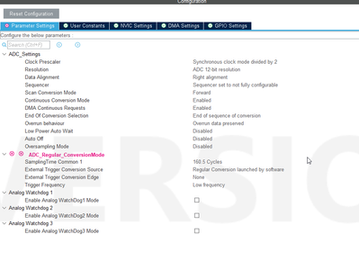

Where is mistake ? It measures only CH0 and copies to all buffer spaces 0-8. I would like to used DMA which worsk fine but DMA can do 8 ch RANKS only  i need 12 in future slow measuring of resitors

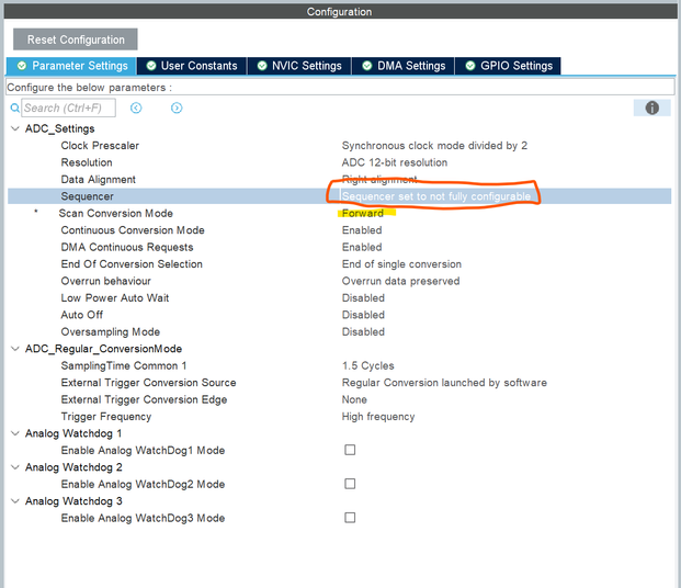

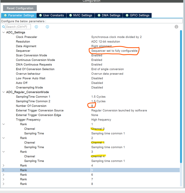

You set number of conversion to 1 and your rank selection is channel 0. So that is the only channel being used.
If want 8 channels then select 8, and adjust each of the ranks to select the channels in the order you want.
And in your code you will have 8 channel configurations. In your case, your code only showed 1 configuration

With Ranks you get only 8 channels. To get 12 you need to use regular Sequencer. The ADC conversion goes in order from the lowest ADCx and goes forward, or backwards if selected.

The GUI only allows you to select up to 8 Ranks. Even the link you posted shows what to do, if you want more than 8 channels.

Thanks for reply. Now It seems to read all defined ADC1 channels via DMA to buffer. There is one item abou .ioc configuration, beside it sometimes freezes under win10 It shows this erros but unable to roll or check what is wrong. Is there any solution/update for .ioc confirugration gui
Not sure offhand what the error is about. Upload the ioc file.
