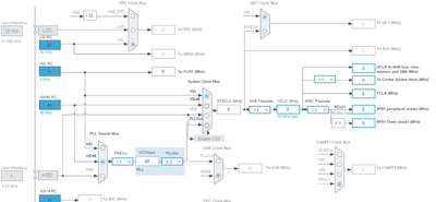

I use STM32F042C6U6 processor. I use IN 2, 3 and 4 inputs for ADC, but when I activate channel IN 4 input, there are serious deviations in other ADC values.

My Clock Settings
