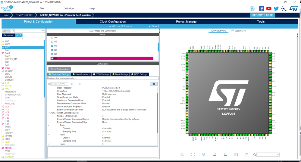

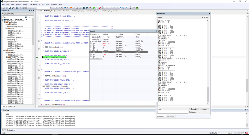

Hello, I am using the Stm32F769BI MCU.
I am receiving 3 ADC channels through DMA.
My problem is that debugging stops in the middle due to HAL_ADC_IRQHandler during debugging.
To debug again, I must press the Run button again.
I want to know why interrupts happen and stop. And I don't want to stop debugging in HAL_ADC_IRQHandler.

    GPIO_InitStruct.Pin = S_ADC_0_Pin|S_ADC_1_Pin|S_ADC_2_Pin;
    GPIO_InitStruct.Mode = GPIO_MODE_ANALOG;
    HAL_GPIO_Init(GPIOF, &GPIO_InitStruct);

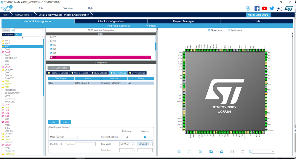

    /* ADC3 DMA Init */
    /* ADC3 Init */
    hdma_adc3.Instance = DMA2_Stream0;
    hdma_adc3.Init.Channel = DMA_CHANNEL_2;
    hdma_adc3.Init.Direction = DMA_PERIPH_TO_MEMORY;
    hdma_adc3.Init.PeriphInc = DMA_PINC_DISABLE;
    hdma_adc3.Init.MemInc = DMA_MINC_ENABLE;
    hdma_adc3.Init.PeriphDataAlignment = DMA_PDATAALIGN_HALFWORD;
    hdma_adc3.Init.MemDataAlignment = DMA_MDATAALIGN_HALFWORD;
    hdma_adc3.Init.Mode = DMA_CIRCULAR;
    hdma_adc3.Init.Priority = DMA_PRIORITY_LOW;
    hdma_adc3.Init.FIFOMode = DMA_FIFOMODE_ENABLE;
    hdma_adc3.Init.FIFOThreshold = DMA_FIFO_THRESHOLD_HALFFULL;
    hdma_adc3.Init.MemBurst = DMA_MBURST_SINGLE;
    hdma_adc3.Init.PeriphBurst = DMA_PBURST_SINGLE;
    if (HAL_DMA_Init(&hdma_adc3) != HAL_OK)
      Error_Handler();
    __HAL_LINKDMA(hadc,DMA_Handle,hdma_adc3);
    /* ADC3 interrupt Init */
    HAL_NVIC_SetPriority(ADC_IRQn, 0, 0);
    HAL_NVIC_EnableIRQ(ADC_IRQn);

Mohamed Aymen HZAMI
Try to remove the printf function.

A few things:
(1) Your HAL_ADC_ConvCpltCallback() function is writing past the end of your air_adc_buf[] array. The array has 3 elements (0 to 2), but your for() loop goes from 0 to 3 (inclusive). Change "<= 3" to "< 3".
And a better (more maintainable) coding practice, make the array size a define and use that define everywhere. For example:
#define ADC_BUFFER_LEN  3
//adc
 uint32_t air_adc_buf[ADC_BUFFER_LEN];
 uint32_t adc_val[ADC_BUFFER_LEN];
And later:
/* USER CODE END 0 */
void HAL_ADC_ConvCpltCallback(ADC_HandleTypeDef* hadc)
  //buffer clear
  for(int j = 0; j < ADC_BUFFER_LEN; j++){
    air_adc_buf[j] = 0;
And still later:
  HAL_ADC_Start_DMA(&hadc3, &air_adc_buf[0], ADC_BUFFER_LEN);
  HAL_ADC_Start_IT(&hadc3);
(2) Why are you calling BOTH HAL_ADC_Start_DMA() and HAL_ADC_Start_IT()? Pick one or the other, I'm guessing the DMA version.
(3) Why do you clear air_adc_buf[] in the conversion complete callback, and then assign values from that array (which are zero) to adc_val[]? It seems you will always get zeros in adc_val[], no?
