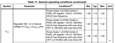

You need to check your hardware of your own board. Check the VCAPx pins voltage and compare them to what was stated in the datasheet:
Check also the power supply VDD.
Did you refer to the documentation like AN4661 when you started to design your board (see Figure 24 for reference design)?
