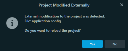

0693W00000BagYBQAZ.gifHi,
I'm just starting with TouchGFX but quite familiar with STMCubeIDE and various chips.
Issue 1 - I have a STM32F769I-DISCO board and I'm unable to download any code onto the board. I get the below error

Issue 2 - I continually get the above reload prompt popping up even though I've not change a thing.

Romain DIELEMAN
Are you working on a custom project or did you use the application template for the STM32F769I-Disco board available in TouchGFX Designer ?
/Romain
NW27
I used the application template for the STM32F769I-Disco board available in TouchGFX Designer and a blank project.
