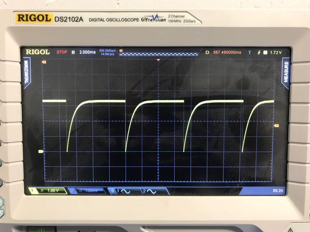

I can connect with JTAG via SWD and load a simple program but after load the system won't run to main. The chip seems to be stuck in some hardware system reset loop. Attached is an image of the nRST pin. I've gone through AN4661 many times and can't figure it out. Power rail looks good and I have BOOT0 strapped low, PDR_ON strapped high. Any ideas?

    As AvaTar mentioned before - run the debugger on that bootloader code (or LED toggle code) and see what happens. You will need to figure out how to tell your IDE to NOT "run to main" but instead allow you to single-step from the reset vector.
    Also, check the option bytes using whatever programmer you are using, specifically the "user configuration" bytes. Is it possible that when programming the custom bootloader that somehow the option bytes got changed to enable one or more watchdog timers? Or change the boot selection options? I don't THINK this is your problem because the reset period looks the same as your first scope screen shot. But these are (or should be) easy things to check.
    Also check the brown-out reset voltage in the option bytes and make sure it matches whatever power supply voltage you are using.
    Otherwise, double-check for some kind of power supply issue. Is the 2.2uF cap you added/changed still attached with good solder joints?

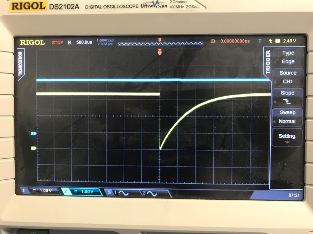

    Watchdog is disabled. Here is a picture with the 3.3V power rail (blue trace). Yellow trace is the nRST signal. I zoomed in to 10ns divisions and there is no drop on the rail.

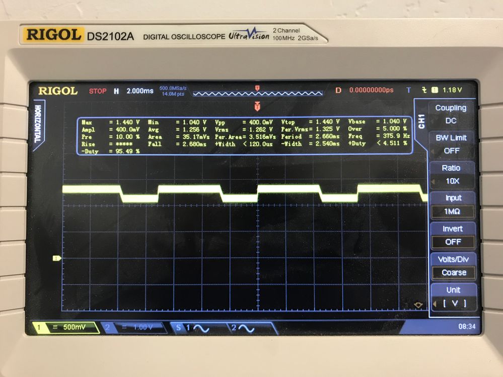

    VDDA = 3.3V
    VCAP = 1.2V with odd ripple (see trace)

    3.3V Power rail ripple

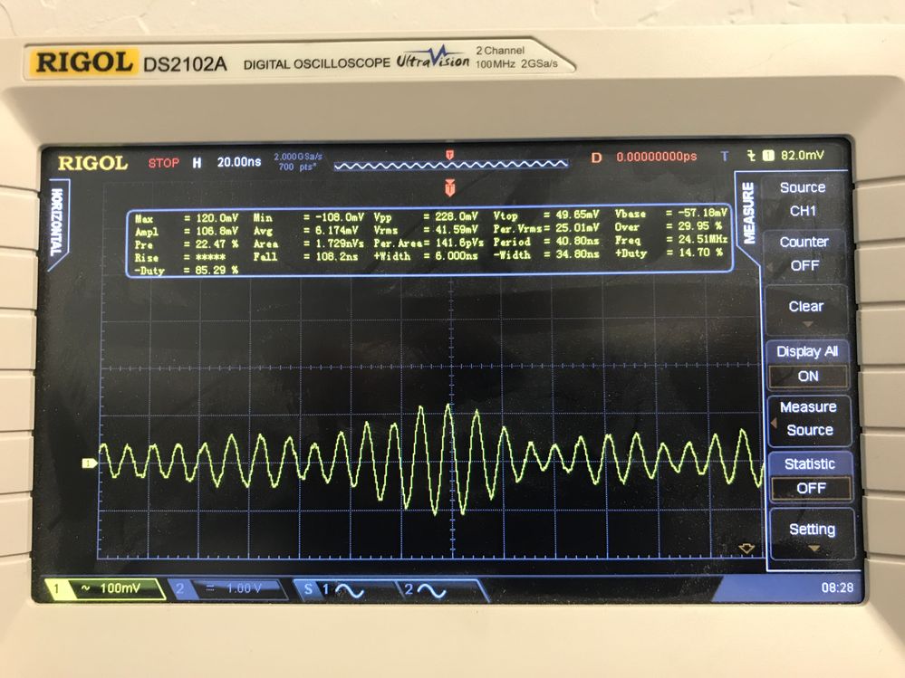

    power is probably not the cause,
    although I have never seen a power supply working so hard as yours is..
    are you light on capacitors ? did you use good capacitors ?
    can you redo that last pic across a Vdd-Vss Cap next to the processor ?
    and again Vdda Vssa Cap.
    ( I mean to move both the scope "ground" and "probe", right across the capacitor.)

    Scope trace with smaller loop across vdd/vss. The vdda/vssa looks the same.

    yes it looks much better
    yes, 2.2uF is necessary.. 1uF is just too light.. they requested low ESR in some datasheet
    Then, around the processor, I use a 0.1u and a 1u as you do, it works well.
