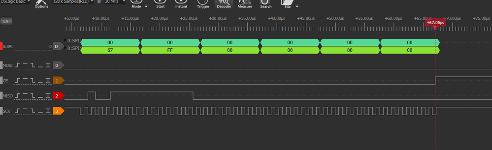

I modification my code to control NSS pin by software:
GPIO_InitStruct.Pin = LL_GPIO_PIN_4;
GPIO_InitStruct.Mode = LL_GPIO_MODE_OUTPUT; GPIO_InitStruct.Speed = LL_GPIO_SPEED_FREQ_VERY_HIGH; GPIO_InitStruct.OutputType = LL_GPIO_OUTPUT_PUSHPULL; GPIO_InitStruct.Pull = LL_GPIO_PULL_NO; LL_GPIO_Init(GPIOA, &GPIO_InitStruct);and here is my log scope, where I send 3 dummy and read 3 bytes....

‎2018-05-30 6:41 AM
Well, the SPI has 4 words FIFO, so that you can write 4 times to DR in a row and the SPI shall generate the correct waveform with CE down for the duration of 4 time 8-bit characters. Can you observe that ? Then manage your reception.
‎2018-05-30 6:50 AM
Some peripherals like the nSS to be active between bytes,
But others like it to run over the whole command.
where is the nSS line trace ?
‎2018-05-30 7:04 AM
NSS = CE on my picture.- Mark as New
‎2018-05-30 10:41 AM
Can you see that nSS is not high then going low to start the command.
you need nSS to be high on startup.
