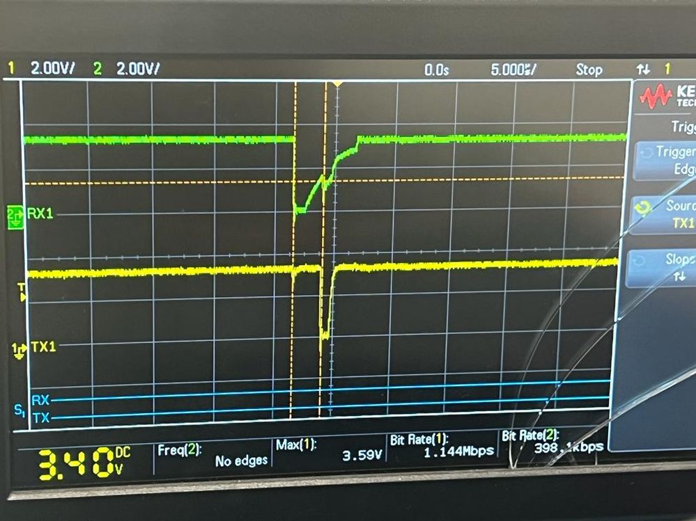

The UART expects 8E1 (Even Parity) for the 0x7F test pattern. Scope the signal make sure it's not glitching, and that you give enough time between doing a reset and sending a pattern. Make sure your UART output pin is high before reset.

The UART output pins are high before reset, I also added 10k pull up to ensure that. both Rx and Tx are glitching at the time I call bootloaderVector->resetHandler(). Rx signal receive 0x7F but no respond transmitted on Tx.
I removed __disable_irq() and not calling HAL_NVIC_SystemReset(), but it didn't change the situation.
After moving the boot jump to be called before SystemClock_Config() it worked, so I looked for the issue inside this function and found that RCC->CCIPR CLK48SEL was enabled so I set RCC->CCIPR = 0 before the transfer.
With this fix, I tried again to update the FW and I see that if I my software is running for more than ~450 ms (just used HAL_Delay for that before the main loop), it fails to upgrade, and again no respond seen on TX.

I finally managed to fix the issue for G4 MCU!
I was pretty confident that I had a SW issue because FW update from UART worked using BOOT0 pin, but it didn't when I jumped to system memory from SW.
On one try, I had the USB cable connected on the MCU side, and disconnected from the host side, and it appeared to work. I thought, it was a coincidence, but I managed to find a pattern.
Long story short, after using a 100K ohm resistor for at least one of DP or DM lines (and even when I just used scope on these lines, which means ~1M ohm), UART update worked successfully.
I don't know if it's the right solution from EMI aspects, but it's sufficient for me.
None of these happened on F7 MCU, so it might be something in G4 series, or you might have some explanation for this
